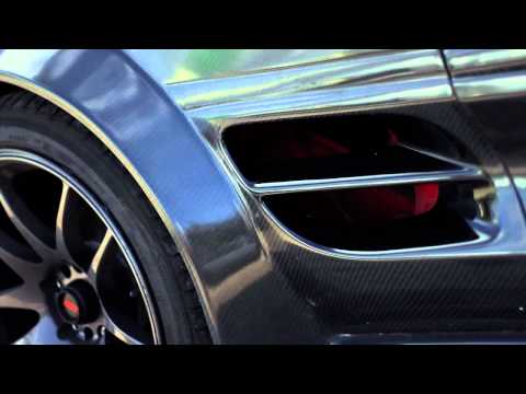

    We have completed the aero kit for the MR2 and the car is now in the bodyshop being base coated to allow us to take moulds from it in the near future. The bodywork has been thoroughly modified in order to increase downforce and engine cooling, which is a common problem with these cars.
    A front splitter is mated to the front bumper in order to increase downforce and stability, this is smoothed into the front wheel arches. We have employed extended sills to prevent bleeding of air from the sides to the underside and thus keep the downforce below. Vents behind each wheel evacuate hot air from the brakes and keep flow moving through this area. A vented flat engine lid will feed air to the engine and cooling devices, whilst a fan arrangement pulls the hot air from the bay and vents it through the boot and vented rear panel.
    As you can see the completed item looks very purposeful and should provide a good level of downforce and sufficient cooling for this and an upcoming engine converted MR2. We are keeping the individual items as separate as possible to allow customers to make a modular upgrade to their car with our parts. Stay tuned.
